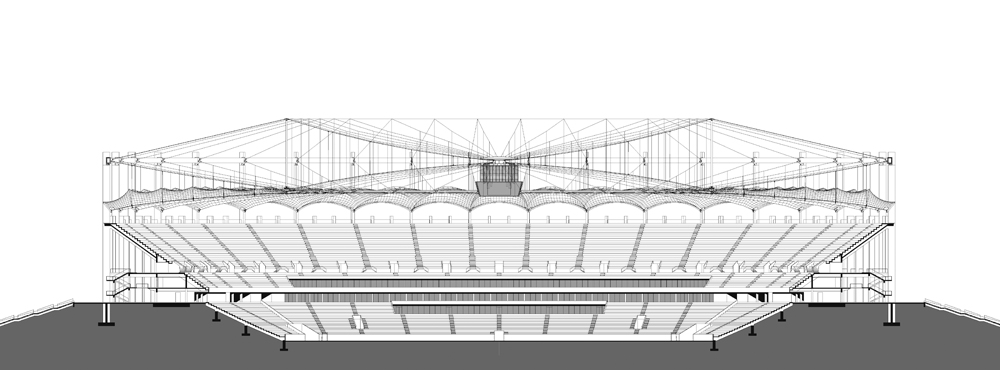

Vancouver
Bucharest
Warsaw

That bucharest section plan is wrong. I measured the section plan and its wrong.Shouldn't surprise anybody,lots of section plans aren't accurate.Even the Old Trafford one i uploaded is wrong.(the legroom according to it would be i think 55cm,which is impossible).

Location: Bucharest
Posts: 1,404
Likes (Received): 182
Originally Posted by www.sercan.de View Post
or meybe its just a small picture or generak just pixel
I can guarantee you that the upper tier is not that steep.I've sat in it 3 times this year.The rest is good,just the angle of the upper tier is wrong.
Bucharest
Looks like a fantasy helicopter design from before the flight era.
