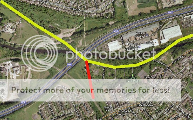

The proposed route for the Stockport extension was meant to get very close to, and maybe even run parallel to, the Hazel grove line for a short section. Here's a map I just drew:
(Yellow - Stockport Extension as described on lrta.org, Red - my guess as to route of Hazel Grove connection)
The junction between the two routes would be situated in the currently derelict Gorsey Bank, so there does not seem to be an issue of space. Furthermore, I was given to believe that the main obstacle to the Stockport line was the prohibitive cost of 3 bridges, thus the construction of the first (and most expensive one) will significantly help the CBR of the Stockport line. The proposal of an extension to Hazel Grove actually makes me much more hopeful about the Stockport line.
Isn't the ascent to Cheadle Heath too steep from Gorsey Bank? The old railway used to be much higher across the valley, although that was designed for steam do maybe it isn't comparable?

Certainly the embankment on the North side of the first bridge (crossing the M60 and the river simultaneously) would have to be very large. There actually already is a large embankment there, but I think it might only be as high as the road surface on the M60, so they'd have to add another 16 feet for it to clear to road (or the bridge could be sloped).
I don't think any large slopes would be required on the south side - the bridge taking the current goods line across the M60 isn't particularly tall, so if the new metrolink bridge cleared the motorway, it would be the correct height.
The place I was most concerned about is the drop from Gorsey Bank to King's Reach - this would be quite a slope. The area on the South bank is very overgrown, so it's hard to see how big the drop is, but I'd imagine that they would need to cut out a fair bit of sandstone to get a reasonable alignment.
Do it like this
And you still only need 3 bridges (2 motorway bridges and one river bridge this time) and you get a myriad of connection possibilities!
E.Didsbury-Stockport (and beyond )
E.Didsbury-Hazel Grove
Stockport-Airport
Hazel Grove-Airport
E.Didsbury-Airport (not that useful)
Steve N | Click here or scan my QR code avatar to support the A6-M60 SEMMMS route | Click here for scheduled tram locations right now <<< DOWN RIGHT NOW

That's an interesting idea - I like all the connection possibilities, however the current motorway bridge for the goods line is single track, therefore you would need a new bridge there anyway. Also I think the Gorsey Bank - Stockport connection was important to the scheme as they wanted to build a business park there. Basically, Hazel-Grove to Stockport via this route is a bit pointless, but Cheadle Heath -Stockport is not, so either the Didsbury-Stockport or Airport-Stockport should have a station in Cheadle Heath.
Thanks - that is most helpful Gerbil.
I suspect that - if the Stockport extension were to be built at the same time, then there would be a delta junction at Gorsey Bank, so that some Hazel Grove trams could go into Stockport Town Centre.
What intrigues me is how this particular route got onto the list. It is a tram-tran proposal, in that the vehicles would need to be tram-train type on account of the continued use of the line for goods.
But there is currently no passenger service on this line; and hence no multi-million pound annual subsidy that could potentially be diverted into a capital fund. So this line does not meet the criteria set out in the Network Rail RUS.
If it were to happen, then the construction cost would presumably have to come from the GM Transport Fund; but that is likely to be fully committed on the Trafford Centre line and the SEMMMS road contsruction. Nor, on the face of it, would this appear to offer an immediate return in GW-wide GVA improvements - which is what has been suggested will drive prioritising schemes for Tax Increment Fincane investment.
And loading another Soute Eastern flow on the South Western Metrolink arm would appear to create an even more imbalenced system.
On the other hand, it would run through a number of highly built-up residential areas - and could releive the A6 logjam. Long-term, I remain interested in the idea of running a tram-train from Stockport town centre north up Lancashisre Hill to Reddish and Reddish North and Belle Vue. Perhaps they could make a circuit?
