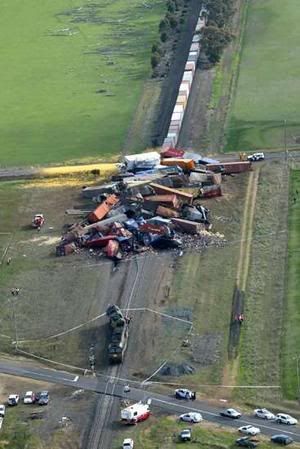

Heavy trains running at high speeds can get into trouble if they need to stop in a hurry ...
this one hit a truck at a level-crossing.

Posts: 1,857
Bloody Hell!!!
I'm assuming the freight train came out of nowhere....

Originally Posted by elfabyanos View Post
Bloody Hell!!!
No, the truck came out of no-where ... but I shouldn't speak ill of the dead.

Posts: 1,857
You can see where the truck hit the back of the loco, or if it didn't it must have been the first trailer. There's got to be a kilotonne of wreckage there. It's a savage reminder of why road should not argue with rail.

The train had right-of-way.
I don't know the details of this accident but it could have been avoided if the truck driver had stopped before the level crossing, looked and listened for trains in both directions. If he had done this he would have seen and heard the train. The track is straight and looks to be flat for some distance on both sides of the level crossing so seeing the train shouldn't have been difficult.
I don't understand the problem some drivers seem to have at railway crossings. Trains are heavy and take a long time to stop, so they have right of way, not motor vehicles on the road.

I was just trying to pint out that running thousands of tons of freight atr very high speeds can have catastrophic consequences if something goes wrong.
I'm not excusing this accident in any way ... the truck driver should have seen the train and given way to it, the crossing should have been clearly sign-posted, etc. ... but this accident happened last year, and while it was notable, it certainly wasn't the only one. As I recall only the truck-driver was killed, but this was the main east-west freight line across southern Australia. an economic catastrophe.
Personally, I crossed railway lines without boom-gates at least six times in the last couple of days ... it makes me nervous.
