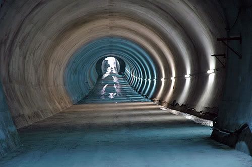

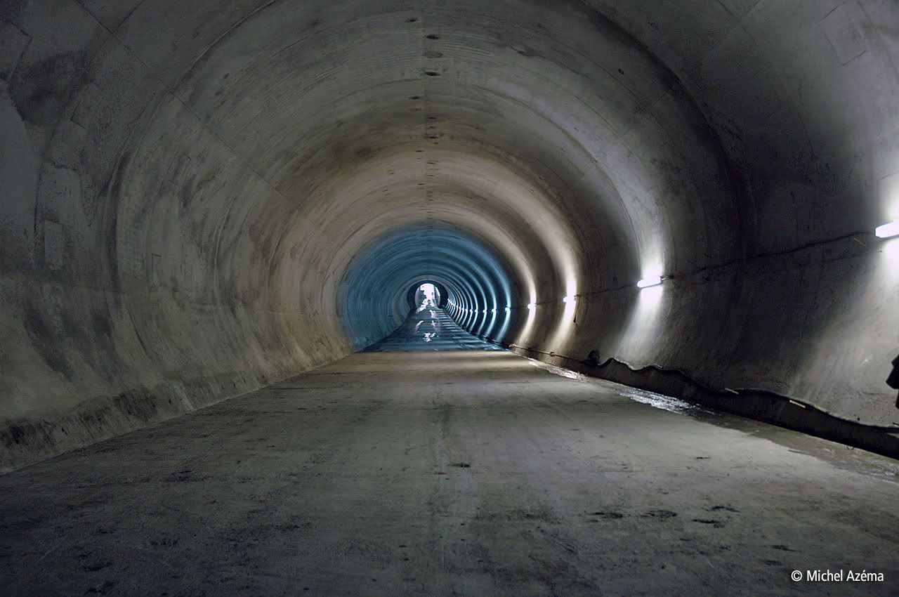

This summer it will be opened They are building the stations now.
this is an old pics
these are current pix
