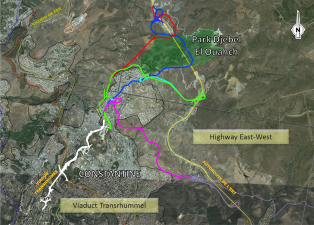

Connection to East-West Highway
LOCATION
Constantine, Algeria
SERVICE DATE
2017 (Predicted)
GENERAL FEATURES
• Length: 7 km (Alternative E)
• Cross section:
- 3 km - 2 x 2 lanes
- 4 km - 2 x 3 lanes
• 1 interchange
• 2 roundabouts
• redesign of 5 intersected roads
• 1 viaduct
• 2 overpasses
• 1 underpass
• 10 retaining walls
• Earthworks: 1x106 m3
http://www.lcwconsult.com/en/portfo...-oeste/gallery/projectos-vias-de-comunicacao/
