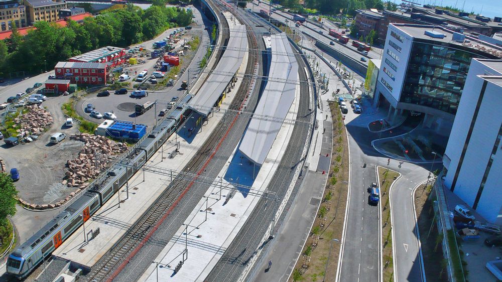

There are no issues that I am aware of at Lysaker at least.

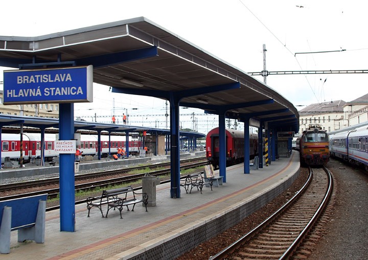

Bratislava hlavná stanica
Reactions: 2
