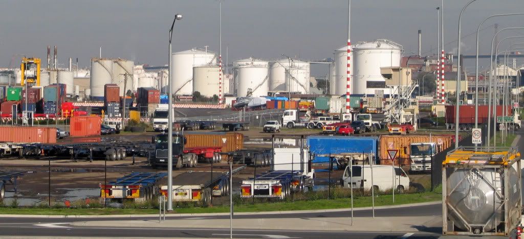

Coode Island, a favorite for overseas tourists here:

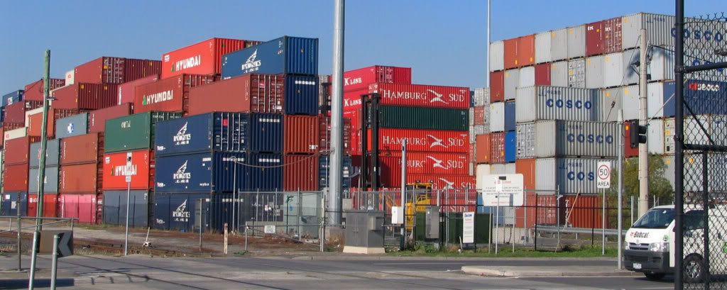

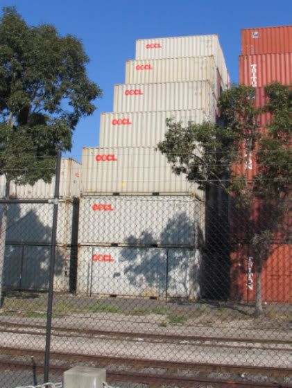

I've wondered for a while just how high they will stack these things: I found a pile of seven, and then one eight-high :

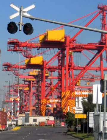

Swanston Dock East:

Is it true that the containers are never returned and just stockpiled at docks?
I heard on the radio about a guy building a house of them, lol.

I often wonder when I see so many containers stacked around the PoM: it would be a good intellectual exercise for kids (or adults) to make an estimate of just how many there are here.
Doubt that there are many hoboes living in there, though ... ten years ago (during the big stand-off with Peter Reith) I took photos on streets I can't set a foot on now. Lately, even the street-directrory has changed the whole area to pink, or pink stripes: verboten.
Rumour had it that the PoM was an actually a very cheap place to store containers ... which is maybe why they're even eight-high now ... wouldn't happen in NYC.

I doubt the containers are never returned. There are companies that own them, I don't see why they wouldn't want them back. It might be that they don't need them at the moment, or they are waiting for a large enough pile that they can ship them somehere else in a bulk load? I don't know but they would be worth something in scrap metal at the least if they weren't wanted.
2,078 Posts
Slightly off topic I know, but with an imbalance of countries with net imports and net exports, a lot of those shipping containers travel empty from the net importers back to the net exporters, and it's effectively a waste of energy and space when it's more economical just to scrap them and build new ones where they are needed. On Eco Report this weekend they were talking about some places using old containers and converting them into buildings like lego blocks, rather interesting. Some entrepreneur in China has also found use for empty shipping containers by transporting waste from America and recycling it to create new goods.

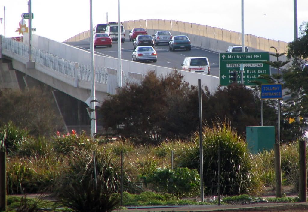

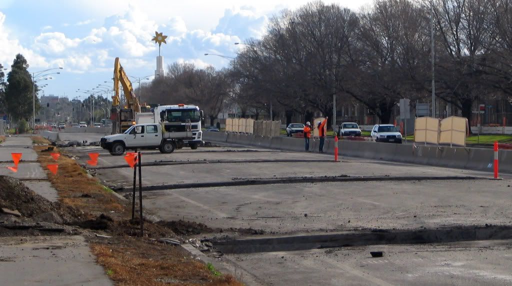

For those that missed it, west-bound traffic from the Melbourne CBD along Footscray Road was switched to the new overpass featured above a week or two above:
The view from the opposite direction. At the top of the bridge, at least one side-viaduct into the docks area to the right is functioning; the other still needs quite a lot of work:

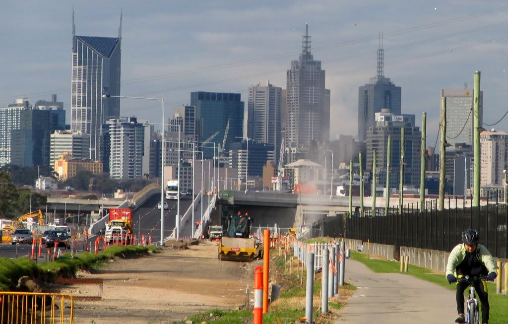

The west-bound lanes of Footscray Road are now being cut-up (in 10 metre sections or so by the look of it), prior to its removal in order to construct a parallel road viaduct to carry east (city-bound) traffic. That strange thing in the sky in the background identifies the Melbourne (wholesale) Flower Market.

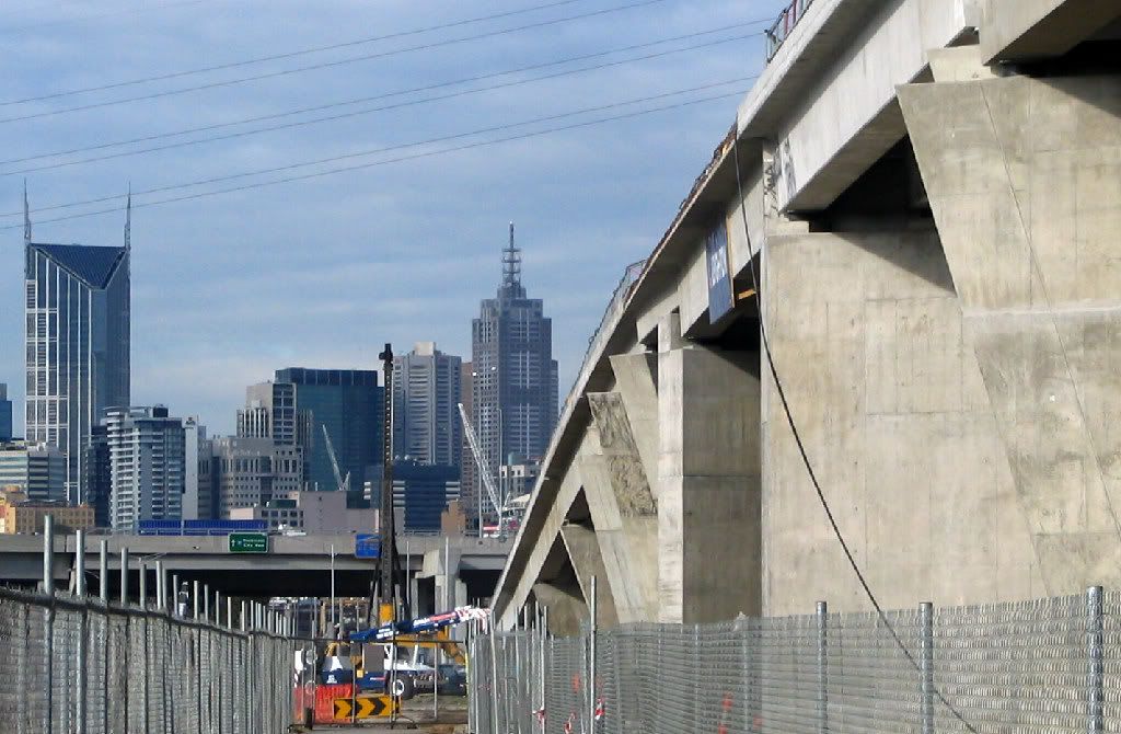

The centre of the viaduct. The large openings in the foreground will carry the new rail lines into the port, and do look high enough to carry double-stacked containers. There will be a rail junction to the left here, with double tracks running under the viaducts to the extreme right and also less acutely from the angle of vision to Appleton Dock:

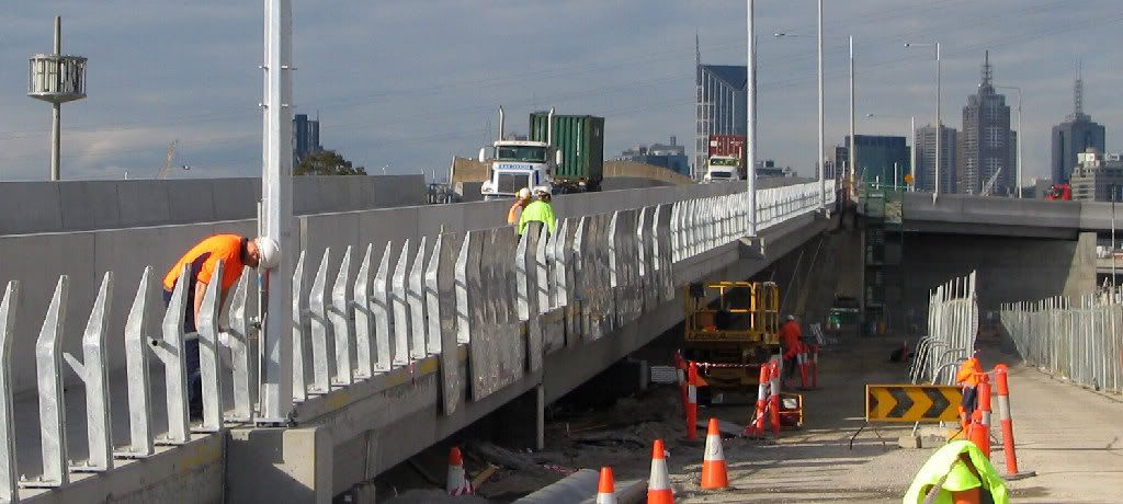

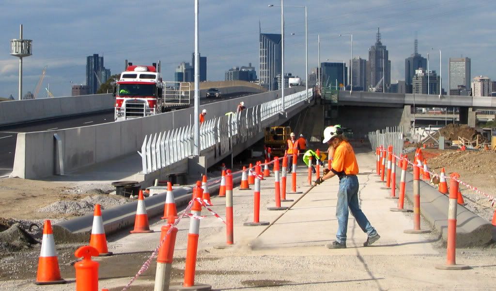

Fitting the bridge parapets. There is a very popular cycle path here: I'm not sure whether it will go over or under the bridge.
