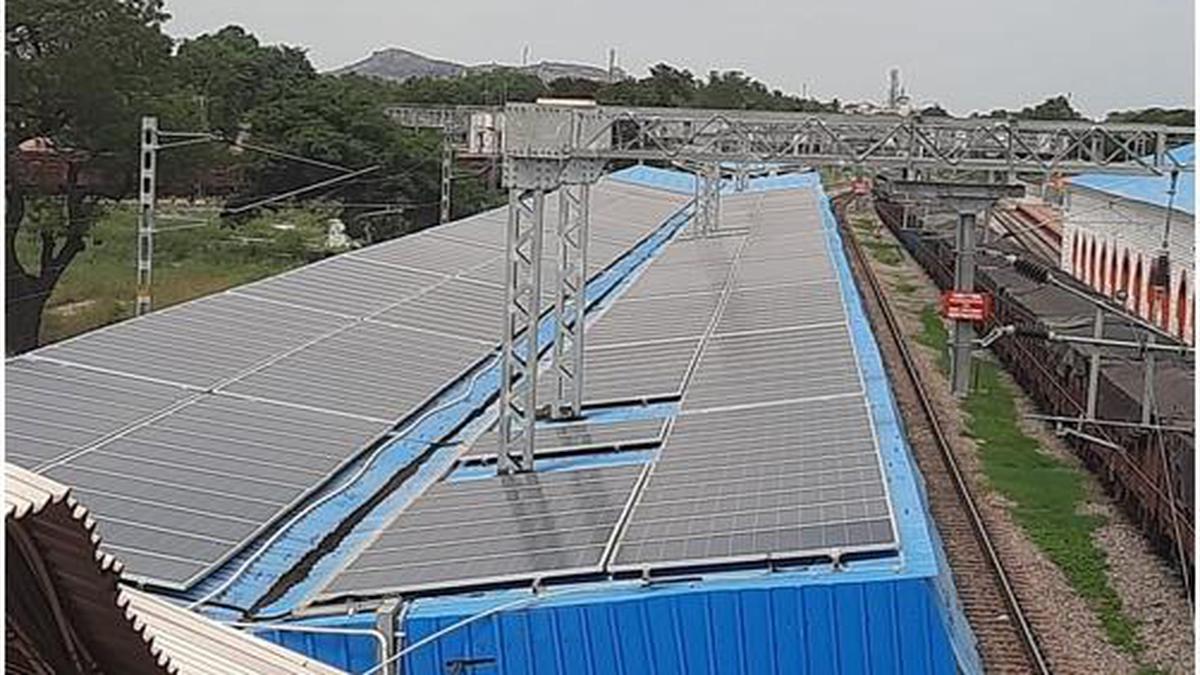

India added 521 megawatts (MW) of rooftop solar capacity in the second quarter (Q2) of the calendar year (CY) 2021, a 53% increase quarter-on-quarter (QoQ) compared to 341 MW installed in Q1 2021 (January-March), said Mercom India Research’s newly released Mercom India Rooftop Solar Market Report Q2 2021.
